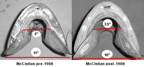

First and foremost, the stirrup loop was moved forward on the tree by 1 1/4″, much closer to the pommel. There are a few examples out there that show some evidence that a small number of the nearly completed saddles were taken back and modified to the new standard. All appear to have been done in 1907. Looking at Ordnance drawings, you see that a slight reduction in the width of the gullet and sidebars of the tree was also made. This is observable when comparing earlier 1896/1904 Pattern 1 trees to the later Pattern II. The difference was about 1/2″, and remained consistent in the arsenal drawings for the next ten years.
Size Variations: However, while the drawings were consistent, a lot of collectors have seen and have examples of varied dimensions – some are exceedingly close to the specification, and some have been found to be upwards of an inch wider. While the exact reasons have yet to be found, it is known that Rock Island Arsenal was not adverse to acquiring saddletrees from commercial sources, and may have been lax in enforcing the specifications.

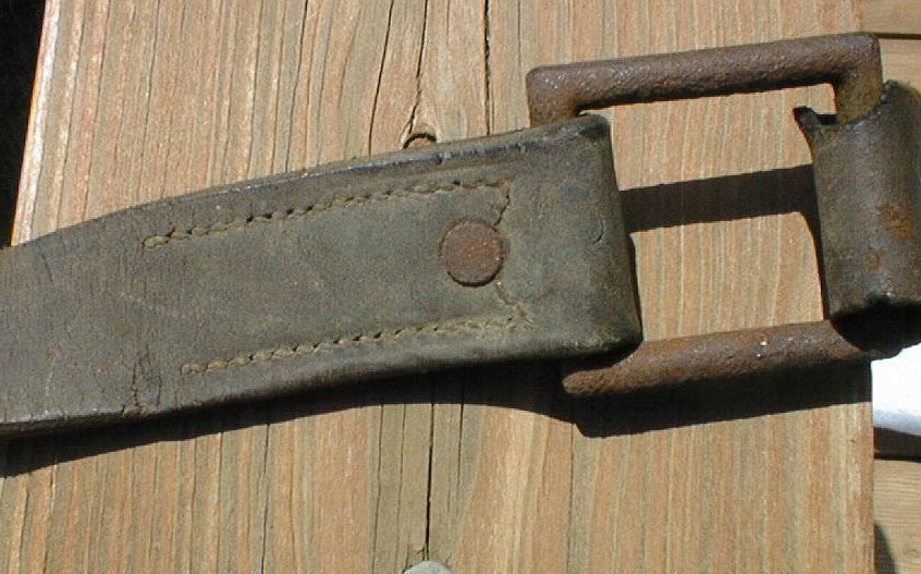

A key identifier for early M1904 Pattern I and II saddles was the use of jappaned iron tubular rivets and caps for certain very defined locations.  On the seat, these were used for reinforcing the folded and stitched laps that held the rigging squares.  The stirrup hoods were also attached with these same types of rivets and caps.  The iron tubular rivets and caps were highly prone to rusting, and the limited locations where these were used are rather puzzling – they were clearly inferior to standard brass rivets and burrs.   All jappanning of brass/bronze parts was replaced with chemical bronze/black finish – somewhere between June 1908 and February 1909.
Stirrup hanger loops were iron, and this characteristic will clearly id a M1904 Pattern I and II, made from late 1907 to early 1912.
