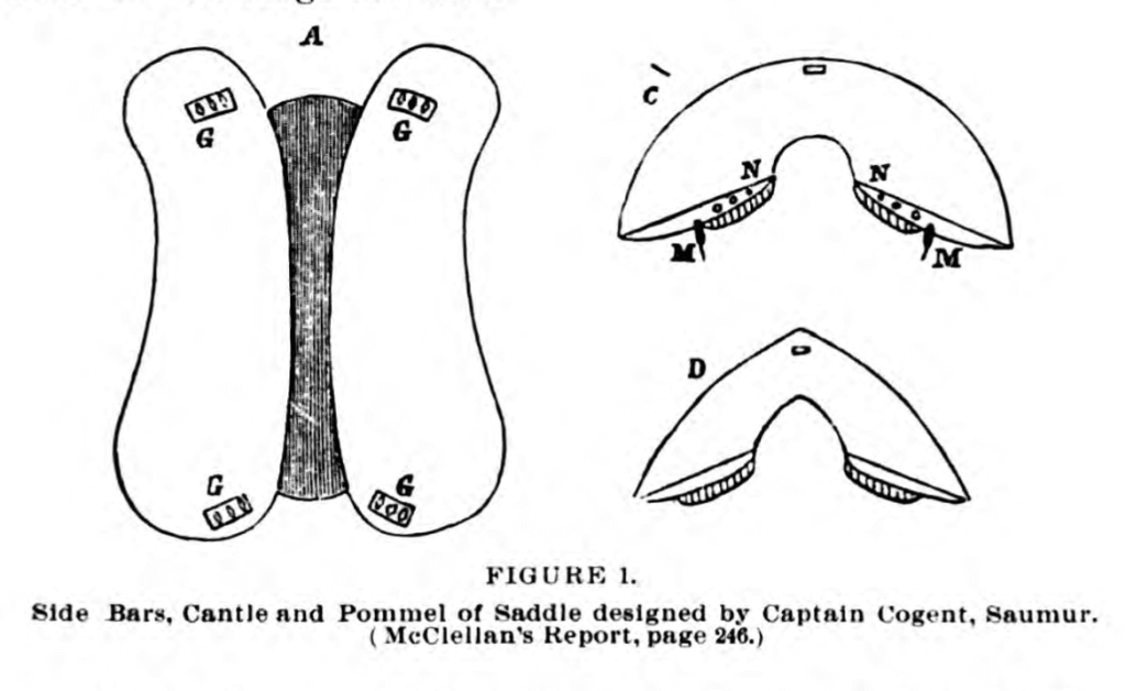

Studying the observations on the cavalry of the European nations above enumerated, we find reference to equipment in each case, but only two saddles are described in detail. One of these is the Hungarian saddle, a type which is of no interest in this particular research. On page 246, under the discussion of French horse equipments, we find the following remarks and the sketches which appear next below:
The new saddle (i. e., new in comparison with another French saddle) is the invention of Captain Cogent, director of the saddle factory at Saumur. The tree is cut out of a single piece of white wood, the cantle only being glued on; a piece of walnut, the grain running across the tree, is let into the pommel. The whole is covered with wet raw hide, glued on and sewed at the edges; no iron bolts or fastenings are used.”
The earliest official description and drawings of the McClellan saddle are thought to be those contained in the Ordnance Manual of 1861, and are here reproduced:
“Saddle-tree-wood (beech); 1 pommel, made of 2 pieces framed together at top and glued; 1 cantle, formed of 2 pieces like the pommel; 2 side-bars (poplar), each made of 3 pieces glued together. The tree is covered with rawhide, put on wet and sewed with thongs of the same and held in place by stitches through the wood along junction of the pommel and cantle with the side-bars, etc.”
A comparison of the preceding sketches and other data, together with a consideration of all the circumstances, leads us to the conclusion that the McClellan saddle may have been suggested by the saddle of Captain Cogent of Saumur. This factor or coincidence, as the case may be—is a welcome though rather unexpected addition to the growing association between our service and the famous French school of equitation, the methods of which are being incorporated to a great extent into our own general scheme of instruction.
[ This is where Capt. Davis made a clear error, although it can be forgiven, as the drawing in the Report of Cogent’s saddle is atrocious.
Cogent saddle tree, bare
Cogent saddle, bottom view.
Images from Roemer, Jean. Cavalry; Its History, Management, and Uses in War. D. Van Nostrand, 1863, pp. 492-3.
These preceding images show a better depiction, illustrating how wildly different Cogent’s design was from any aspect of the approved McClellan tree – ed. ]
An important feature of Captain Cogent’s saddle, which certainly was not incorporated into our service saddle, was his manner of arranging it so that a single size would suffice for all horses, or for the same horse as his condition of flesh varied. This was effected by attaching to the under surface of each side-bar a thin strip of cork which was faced with a layer of felt on the side next to the horse and by a leather pocket or flap on the side next the saddle. Lateral and longitudinal adjustability or changes of fit were attained when necessary by inserting additional strips of felt in the leather flap. Looking back from the present vantage point of increased experience and information, it is apparent that our service saddle would have given better results if it had been equipped with felt pads for the side-bars.
