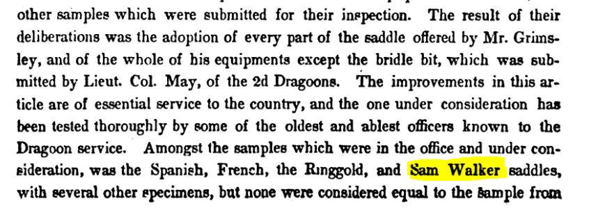

Would this be the same 'Sam Walker'?
From:
M. Tarver and T.F. Risk, eds., "Grimsley's Dragoon,
or Military Saddle-Tree," The Western Journal of Agriculture,
Manufactures, Mechanic Arts, Internal Improvement, Commerce
and General Literature, l(February, 1848)
Discussion on the selection process (or formalizing of the already accepted Grimsley dragoon saddle as the regulation pattern) -
would this 'Sam Walker' be the same 'Sam Walker' of the big revolver fame?
Hi Todd
I do not know the answer but what might be of interest are extracts of letters from Sam walker to Sam Colt , these are from the book Sam Colt's Own Record 1847.
From Sam Walker to Sam Colt 18th April 1847 New Orleans Barracks.
I have 160 men and am still recruiting for the Regiment and have choice material, Holsters to suit the revolvers were made in Washington with the saddles and ought to be on their way out before this time I shall take my horses with me and shall want nothing but the pistols to go immediately in the interior of Mexico.
In a later letter dated 28th April 1847 from New Orleans, again from Sam Walker to Sam Colt he writes:
believing my saddles would not be sent from Washington in time I have got another full set making here which will be complete in a few days which I am now waiting for, I shall give orders here for a full set of holsters also which will be sent to Vera Cruz as soon as your pistols can reach me.

Brilliant!
Fairly easy to presume that some example(s) of the original Washington order might have fallen into the War Department hands for consideration in the next year.
I so want to think that these were some early Texas style....will take some additional searching though.
Interesting question!
